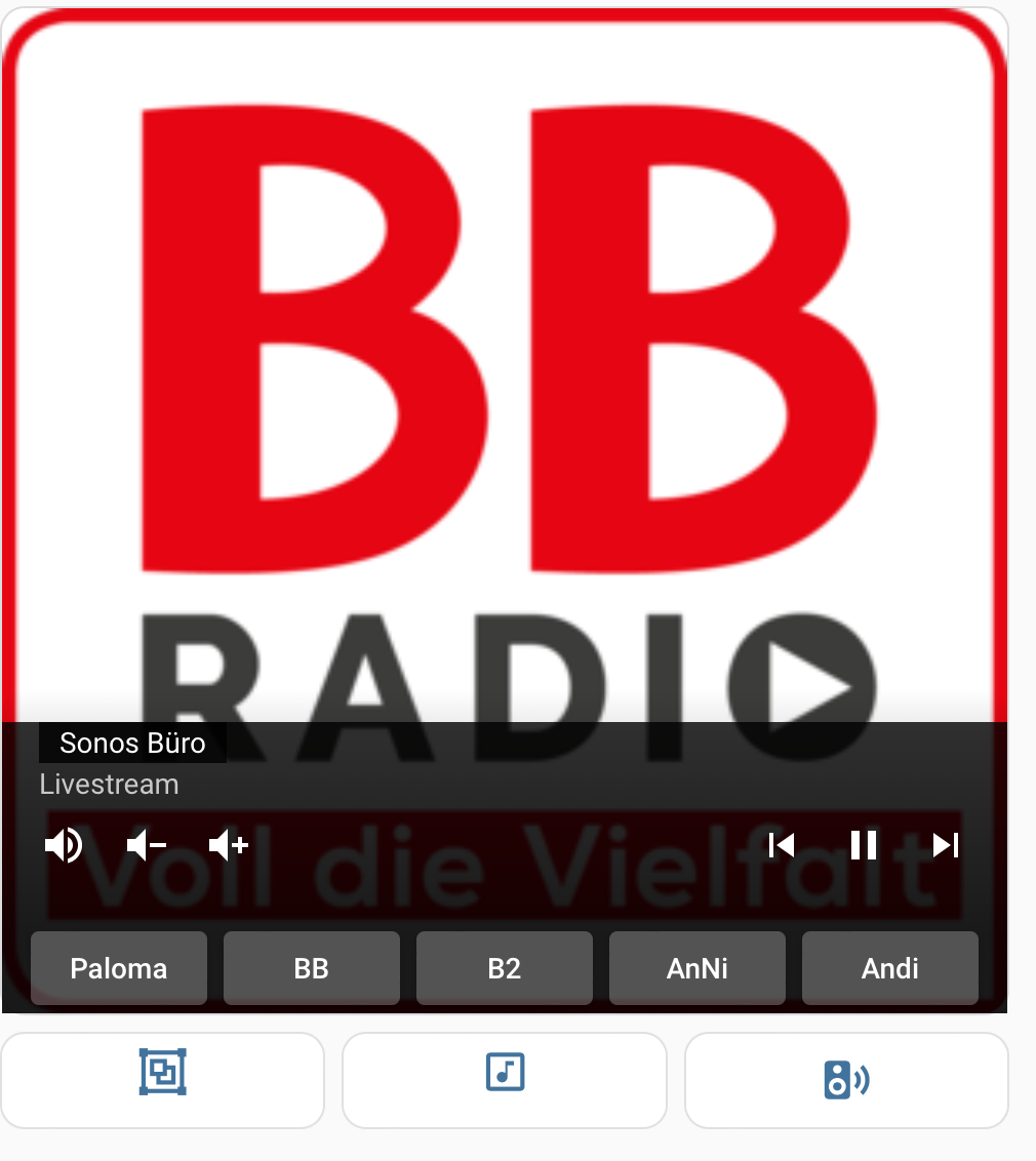

Hallo PX80. Danke Dir. Habe es noch ein wenig umgestylt, sieht jetzt so aus (mit card-mod aus HACS):
Bildschirm­foto 2023-03-20 um 14.01.46.png (262.14 KiB) 2456 mal betrachtet
Ist Geschmacksache, aber so ist das Fenster besser ausgefüllt.
Hier der geänderte Code:

      - type: custom:mini-media-player
        cards:
          - entity: media_player.sonos_wohnzimmer
        group: false
        volume_stateless: true
        toggle_power: true
        info: short
        scale: 1
        hide:
          power: true
          volume: false
          source: true
          icon: true
        artwork: full-cover
        shortcuts:
          columns: 5
          buttons:
            - name: Paloma
              type: script
            - name: BB
              type: script
            - type: script
            - type: script
            - type: script
        style:
            ha-card > div.mmp-player {
            padding-left: 0px !important;
            padding-right: 0px !important;
            padding-bottom: 0px !important;
            --paper-slider-knob-color: white;
            --paper-slider-active-color: white;
            --paper-slider-container-color: #303741;
            ha-card > div.mmp-player div {
            padding-left: 10px !important;
            padding-right: 10px !important;
            background: rgba(0,0,0,0.8);
            ha-card > div.mmp-player div .entity__info,
            ha-card > div.mmp-player div .entity__info__media {
            background: rgba(0,0,0,0);
            padding: 0px !important;
            span:nth-of-type(2)::before {
            content: '\000A' !important;
            white-space: pre !important;
            ha-card > div.mmp-player div .entity__info__media span {
            color: #FFFFFF !important;
            ha-card > div.mmp-player .mmp-player__adds mmp-media-controls {
            padding-bottom: 10px !important;
        cards:
          - entity: media_player.bad
        group: false
        toggle_power: true
        info: short
        scale: 1
        hide:
          power: true
          volume: false
          source: true
          icon: true
        artwork: full-cover
        shortcuts:
          columns: 5
          buttons:
            - name: Paloma
              type: script
            - name: BB
              type: script
            - type: script
            - type: script
            - type: script
        style:
    type: custom:swipe-card
  - type: horizontal-stack
    cards:
      - show_name: true
        show_icon: true
        type: button
        tap_action:
          action: call-service
          service: script.lautsprechergruppe
          service_data: {}
          target: {}
        show_state: false
        hold_action:
          action: none
        icon: mdi:group
        icon_height: 25px
      - show_name: true
        show_icon: true
        type: button
        tap_action:
          service: script.lautsprechereinzel
          service_data: {}
          target: {}
        hold_action:
          action: none
        icon: mdi:music-box-outline
        show_state: true
        icon_height: 25px
      - show_name: false
        show_icon: true
        type: button
        tap_action:
          action: toggle
        show_state: false
        icon: mdi:speaker-wireless
        icon_height: 25px
        hold_action:
          action: none
        entity: group.lautsprecher
type: vertical-stack
Die unteren Schaltflächen swipen nicht mit und sind zum Gruppieren, DeGruppieren und Ausschalten der Lautsprecher (über eine smarte Steckdose).
Gruß
AndiFidi
PS: JA stimmt mit der ShuffleFunktion. Hat am Anfang auch nicht funktioniert, jetzt schon :-)
