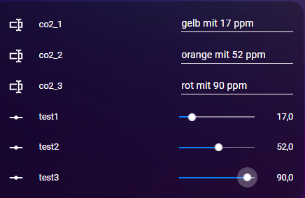

Re: Übergabe einer Trigger-Variable an target
Hier mal mein Original Code, die sensoren habe ich natürlich durch ein mal helfer ersetzen müssen.
Version1:
alias: test trigger to state 3
description: CO2 - Ampel
      - input_number.test1
      - input_number.test2
      - input_number.test3
  - service: input_text.set_value
      entity_id: |-
        {% set ent = trigger.entity_id %} {% if ent == 'input_number.test1' %}
          input_text.co2_1
        {% elif ent == 'input_number.test2' %}
          input_text.co2_2
        {% elif ent == 'input_number.test3' %}
          input_text.co2_3
      value: |
        {% if states(trigger.entity_id)|int <= 10 %}
          grün mit {{ states(trigger.entity_id)|int }} ppm
        {% elif states(trigger.entity_id)|int > 10 and
          states(trigger.entity_id)|int <= 50 %}
          gelb mit {{ states(trigger.entity_id)|int }} ppm
        {% elif states(trigger.entity_id)|int > 50 and
          states(trigger.entity_id)|int <= 80 %}
          orange mit {{ states(trigger.entity_id)|int }} ppm
        {% elif states(trigger.entity_id)|int > 80 %}
          rot mit {{ states(trigger.entity_id)|int }} ppm
mode: queued
max: 10
Version 2:
alias: test trigger to state 4
      entity_id: |-
        {% set ent = 'trigger.entity_id' %} {% if ent == 'input_number.test1' %}
          input_text.co2_1
          input_text.co2_2
          input_text.co2_3
      value: |
mode: queued
max: 10

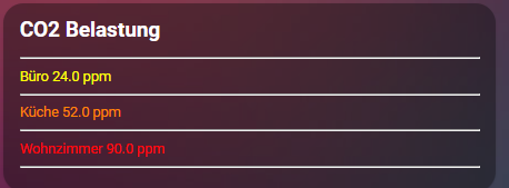

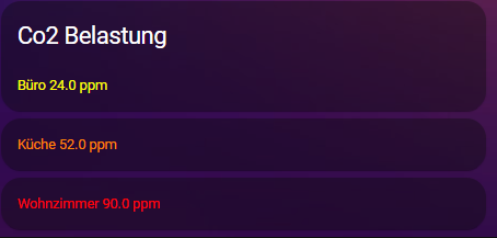

Vielleicht noch eine andere Möglichkeit.
Wenn es Dir nur drum geht die Co2 Belastung auf dem Dashboard zu visualisieren, wäre vielleicht die Markdown Karte auch eine Alternative?
type: vertical-stack
cards:
  - type: markdown
    content: |-
      {% if states.input_number.test1.state | int <= 10 %}
       <font color= #00FF00>
          Büro {{states.input_number.test1.state}} ppm
       {% elif states.input_number.test1.state | int > 10  and
       states.input_number.test1.state |int <= 50  %}
        <font color= #FFFF00>
       {% elif states.input_number.test1.state | int > 50 and
       states.input_number.test1.state|int <= 80 %}
          <font color= #ff8800>
       {% elif states.input_number.test1.state | int > 80  %}
          <font color= #FF0000>
    title: Co2 Belastung
  - type: markdown
    content: |-
      {% if states.input_number.test2.state | int <= 10 %}
          Küche {{states.input_number.test2.state}} ppm
       {% elif states.input_number.test2.state | int > 10  and
       states.input_number.test2.state |int <= 50  %}
       {% elif states.input_number.test2.state | int > 50 and
       states.input_number.test2.state|int <= 80 %}
       {% elif states.input_number.test2.state | int > 80  %}
  - type: markdown
    content: |-
      {% if states.input_number.test3.state | int <= 10 %}
          Wohnzimmer {{states.input_number.test3.state}} ppm
       {% elif states.input_number.test3.state | int > 10  and
       states.input_number.test3.state |int <= 50  %}
       {% elif states.input_number.test3.state | int > 50 and
       states.input_number.test3.state|int <= 80 %}
       {% elif states.input_number.test3.state | int > 80  %}
Oder so:
type: markdown
content: |-
  ## **CO2 Belastung**
