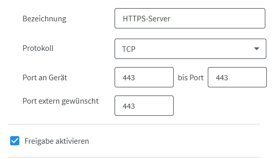

d) FritzBox Portweiterleitung an Raspi mit
  • HTTP 3000
    HTTPS 443
    HTTP 80

Da war meine Frage blöd. Geht der ping auf die richtige IP, die externe Deiner Fritzbox?

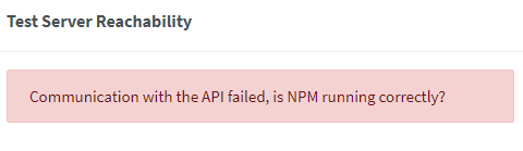

Im NGINX Proxy Manager was das Ceritifact abgelaufen, habs erneuert (expires 17th May 2023)....bringt aber nix?
Protokoll NGINX Proxy Manager
cont-init: info: /etc/cont-init.d/00-banner.sh exited 0
cont-init: info: running /etc/cont-init.d/01-log-level.sh
parse error: Expected string key before ':' at line 1, column 4
[16:56:52] ERROR: Unknown HTTP error occured
cont-init: info: /etc/cont-init.d/01-log-level.sh exited 0
cont-init: info: running /etc/cont-init.d/mysql.sh
[16:56:53] ERROR: This add-on now requires the MariaDB core add-on 2.0 or newer!
[16:56:53] FATAL: Make sure the MariaDB add-on is installed and running
cont-init: info: /etc/cont-init.d/mysql.sh exited 1
cont-init: info: running /etc/cont-init.d/nginx.sh
[16:56:53] ERROR: Unknown HTTP error occured
cont-init: info: /etc/cont-init.d/nginx.sh exited 0
cont-init: info: running /etc/cont-init.d/npm.sh
[16:56:57] ERROR: Unknown HTTP error occured
jq: error: syntax error, unexpected $end (Unix shell quoting issues?) at <top-level>, line 6:
    | .database.port =
jq: 1 compile error cont-init: info: /etc/cont-init.d/npm.sh exited 0 cont-init: warning: some scripts exited nonzero s6-rc: warning: unable to start service legacy-cont-init: command exited 1 /run/s6/basedir/scripts/rc.init: warning: s6-rc failed to properly bring all the services up! Check your logs (in /run/uncaught-logs/current if you have in-container logging) for more information. prog: fatal: stopping the container. s6-rc: info: service fix-attrs: stopping s6-rc: info: service fix-attrs successfully stopped s6-rc: info: service s6rc-oneshot-runner: stopping s6-rc: info: service s6rc-oneshot-runner successfully stopped

Das Log habe ich nur überflogen, dort war von irgendeinem Fehler die Rede und das etwas wieder beendet wurde. Läuft das Add-On wirklich? Ich habe heute leider keine Zeit mehr zum weiteren Nachforschen.
Was mir gerade noch einfällt. Die Fehlermeldung lautet „unable to connect to Home Assistant“. Wer oder was gibt diese Meldung überhaupt aus? Ein Browser kann es ja eigentlich nicht sein, da der ja nichts von Home Assistant weiß, oder?
Oder hast Du einfach nur ein Anmeldeproblem, das ja im linken Menü unter Benachrichtigungen angezeigt werden müsste.
Oben steht, daß Du kein oder ein falsches Maria-DB Add-On hast!

da war was an der MariaDB, sollte wieder laufen, der NGINX Proxy Manager hat aber noch folgende Fehler raus:
[20:17:43] INFO: Starting the Manager...
[20:17:43] INFO: Starting NGinx...
nginx: [warn] conflicting server name "meinname.duckdns.org" on 0.0.0.0:80, ignored
nginx: [warn] conflicting server name "meinname.duckdns.org" on 0.0.0.0:443, ignored

Aber der Zugriff von aussen funktioniert nicht, da hab ich im Nginx Proxy Manager was interessantes entdeckt unter SSL
bzw. unter Edit Proxy Host
Re: Kein Zugriff mehr über DuckDNS

In der FritzBox sind folgende Port-Freigaben
  • HTTPS 443
    HTTP 80
Wie bekomm ich das wieder hin?
